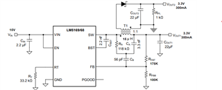

design review especially inductor selection
Part Number: LM5169
I would like to design a isolated supply of 3.3V from a 15V supply. I would like to use the vout2 for this purpose as isolated power. vout1 will be left unconnected to load.
1) is keeping the vout1 unconnected a issue? if so is there any other solution to get isolated supply
2) the inductor i have selected is SRF0703-150M Does this meet the purpose?
