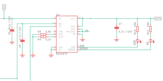

    How much current is current is being pulled at the OUT pin? Can you share a schematic with the LEDs and any information on what is at the OUT pin?
    Anthony Pham
  • Hi Anthony,
    At turning on, we have measured around 350mA.

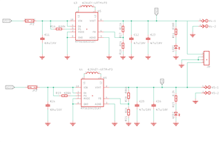

    I can't share you the entire schematic, but I can share you the charger circuit and its following converters:

    I have probably not explained myself properly, the LEDs that are blinking are not /CHG and /PG. The LEDs that re blinking are those called LED1 and LED2 on the output of the buck-boost converters.

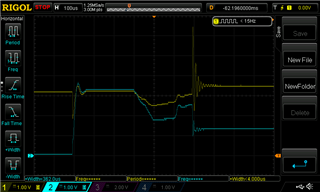

    I have just checked VBAT (in yellow) and VOUT (in blue). Please find attached the voltages at startup:
    This sequence is repeated approximately every 55ms

    Ah if that's the case, can we zoom out a little bit and increase the V/div on this so that they take up more of the screen? It's a bit difficult to read. I can look at the charger waveforms and forward this to the converter team to take a look.

    Please find attached two differents images. As before, yellow represents VBAT and blue, VOUT
    The first one is a zoom to the initial transient when turning on the device.
    The second one is a startup overview. In red, I marked the region which has been zoomed before. This transient is repeated every 56ms as it can be appreciated with the cursors measurements

    Is this right after you're plugging in the battery? I'm looking at your waveforms and I don't normally expect VOUT to be low if there is a batteyry present.
    Anthony PHam
  • Hi Anthony,
    Yes the scope image is taken when plugging the battery (where the red box represents that exact instant)
    We have been reading on forums and also the datasheet with detail, this may be caused by the short-circuit protection of the BQ24075T?
    Jaume
  • HI Jaume,
    Yes this looks to be the case here. The time that you're seeing for every transient happens just about tREC(SC2), the time the device checks for exiting a short circuit event
    Anthony Pham
