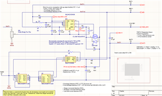

The BQ29705 battery protection circuit and BQ25887RGER battery charger are both functioning properly under normal 500mA current. However, when the battery is fully discharged, the discharge MOSFET fails to turn on as it should when the charger cable is connected via the charger detection circuit. It remains off, and I am still unable to resolve the conflict between the two components.
To address this issue, I added a 0.1uF capacitor between the battery ground and USB_BUS, which generates a negative voltage on the battery ground with respect to the charger ground. This solution works most of the time, but there are still occasional instances where the discharge MOSFET fails to enable again when the battery is fully dead.
Please note that R9 and R31 are DNP. The battery pack is a 2-cell, 7.4V pack, and the BQ29705 is being powered from the middle pin of the battery pack

    The battery pack consists of two lithium-ion INR18650-35E batteries connected in series, with a nominal voltage of 7.4V. The BQ29705 battery protection IC is powered from the middle pin of the battery pack.
    When the voltage of the lower battery drops below 2.5V, the discharge MOSFET is turned off as described in Section 9.4.3 of the datasheet on Over-Discharge Status. Once a charger is connected, a small current flows through the body diode of the DSG FET, and the charger detection circuit can detect this condition by sensing -0.7V. When the voltage detected at the V- pin is higher than -0.7V, the device releases the over-discharge state and allows the DOUT pin to go high, turning on the discharge FET once the battery voltage exceeds the over-discharge detection release hysteresis voltage (VUVP +Hys).
    It's important to note that this can happen even if the battery voltage is higher than the 2.5V UVP voltage when the battery is connected to the circuit for the first time. In this case, once the charger is plugged in, the charger detection circuit should detect and turn on the DSG FET as mentioned in the datasheet.

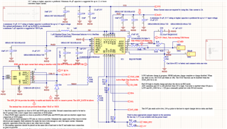

    The battery pack is charged by the BQ25887RGER battery charger using a 5V USB supply. When the USB charger port is connected, the DSG FET is continuously turned off, preventing the charging process from initiating. Here im attaching the BQ25887RGER charger circuit for your reference as well.
