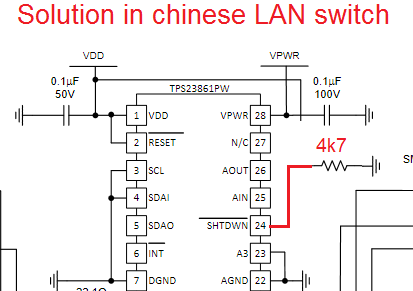

I have exactly the same problem. After a lot tests I found problem with the SHTDWN pin (No. 24). On all shematics applications this pin is connected to the VDD for each work mode.
I made project with this connection.
Sample units purcharsed from european distribution are working ok, but one spool we purcharsed in China. Chips purcharsed in Chin don't want to work with suggested connection of the SHTDWN pin. If this pin is disconnected (float mode) or connected to the GND classification  does start with Auto Mode. I have one chinese LAN switch with the same chip and there SHTDWN pin is connected to the GND over 4k7 resistor.

    I have one chinese LAN switch in configuration Semi-Auto (TPS23861 + microcontroller). There the SHTDWN pin is connected to the GND via resistor 4k7.
    I replaced chip in the LAN switch to purcharsed in China and everything is ok.

    At moment of power on, is the SHTDWN pin already grounded, or is it grounded after?
    When VPWR is connected, is Vdd already connected as well, or is it connected after?
    Nate
  • I turn on VPWR and VDD simultaneously. During power-up, the SHTDWN must be connected to GND or floating - only then the classification is started. If I momentarily connect the SHTDWN pin to VDD the classification turns off immediately and will not start until power is restarted
    If SHTDWN is connected to VDD at power up, changing the state of this pin does not run classification.

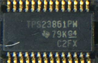

    Will you please send a picture of the top markings on the PSEs that aren't working properly?
    Nate
  • Thanks, Carol.
    Does every part you got from China have the same issue with SHTDWN pin? Can you share who the distributor of the chips is?
    Nate
  • We haven't started the assembly yet but I checked about 15 pieces from the spool and the problem is exactly the same. We bought these chips from a reseller and we don't know who the main distributor in China is. I can ask but I doubt they'll disclose it.
  • Ok, thank you for checking. Will you please ask them the name of distributor?
  • Hi
    I got below information:
    "Hi sir.  We purchased  this 500pcs from a company named “SHENZHEN XINQIFA COMPANY”
    They are not distributors or authorized companies, similar to OEM inventory supplier.
    When the distributor is not in stock, we will consider this source, but we will check it carefully.
    I am sure we checked whether the appearance of the chip is original, but we may have ignored its functions and parameters."
