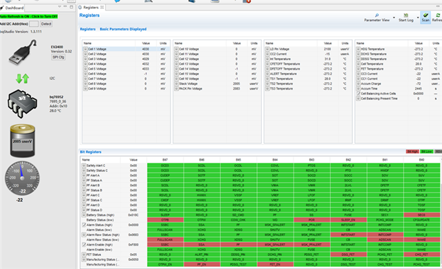

The customer test with BQ76952EVM. In CHGTEST and DSGTEST mode, the charge and discharge switch is turned on.
1. When connected to an electronic load to discharge, the voltage drop of cell16 -> pack+ is 5.17V, the resistance of pack+ -> cell16 terminal is 0 ohms, the resistance can not be measured from cell16 to pack+, and it can be discharged normally with a discharge current of 0.5A.
2. Turn off the electronic load, stop the discharge, measure the resistance of the pack+ -> cell16 terminal is 0.64 kohm, and the resistance cannot be measured from cell16 to pack+

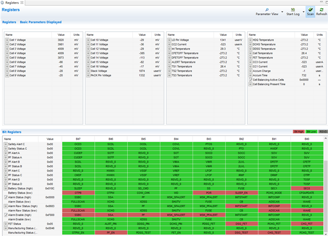

3. After connecting the positive and negative poles of the charger, the voltage drop of cell16 -> pack+ is 4.25V, and the resistance of pack+ -> cell16 terminal cannot be measured, and the resistance of cell16 -> pack+ is 0 ohms; it cannot be charged, and the current is 0.
Screenshot during discharge:
The screenshot when connecting the charger is as follows:

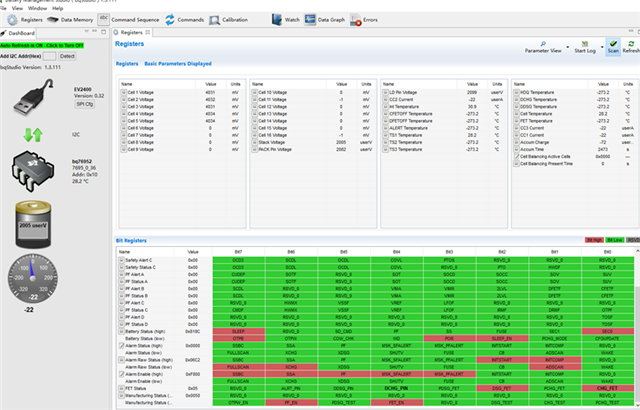

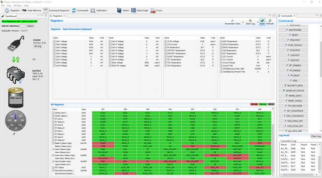

Then turn off the test mode, turn on FET_EN, and then click ALL_FETS_ON, DSG_FET is turned on, but CHG_FET is not turned on. After the electronic load is connected, the CHG_FET is turned on again.
At this time, the opening and closing of the CHG_FET is related to whether it enters SLEEP. At this time, it can be discharged normally. Then connect the charger, no current. The CHG_FET turns on and turns off sometimes, probably due to inaccurate current measurement, even when the pack is disconnected, the measured current jumps from -7mA to -249mA, and is 0 most of the time.
The screenshot 1 when connecting the charger is as follows:
The screenshot 2 when connecting the charger is as follows:

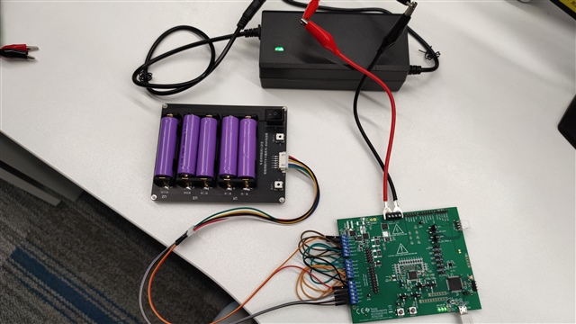

    • Also, just to confirm this is all with the EVM board? Have you tried a different unit/evm? And can you take a picture of your connections so we can look at jumpers and make sure the hardware is configured properly.

    2, The charger is connected to the positive and negative terminals of the PACK of the EVM board; after connecting the charger, turn on CHGTEST and DSGTEST (FET_ENABLE is off), the current display on the BQSTUDIO interface is always 0; there is nothing else on the battery. The following figure shows the line connection. (Shunt jumpers on cell1 to cell16 are all removed, I2C jumpers are fine)
    The circuit of the battery box is as follows: (the battery pack and the EVM board are only connected to CELL0, CELL1, CELL2, CELL3, CELL4, and CELL5)

    What is the CP1 voltage, this should be about ~11-V above the battery voltage. If this voltage is abnormal, then the drivers will likely not be able to drive the FETs properly.
    For these tests are you using the the FET_TEST commands (When FET_EN = 0) ? If so, how do the registers look when the FETs are enabled? DSG_TEST/CHG_TEST should both be SET if using these.
    For autonomous mode (FET_EN = 1), the CHG FET will turn-off during sleep mode by default. For this testing it may be good to disable sleep mode by using the sleep disable command in the Commands window of bqStudio. You can also make the CHG FET stay on during SLEEP mode by changing the settings.
