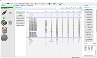

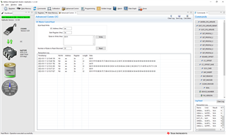

    I think you may not have fully unsealed the bq27220. I tried it and here are the results
    Unsealed state confirmation - check SEC0, SEC1
    Read data memory for reference (crosscheck with data to be read)
    Transaction log - also reading 0x91b4 inbetween to make sure that the values are not stuck
  • I see that bqStudio does read different data from 0x9184, though that does not seem to be the default value CC Gain should have. However this does not solve my issue. I cannot integrate a bqStudio in the device! So the question is what does bqStudio do differently?

  • Hello Sauli,
    bqStudio advanced comm tab is a low level tab that is being used to demonstrate that the commands work. The other screenshots are for reference. You can implement the communication from any microcontroller.
    I think your issue is caused because bq27220 is not in full access unseal mode. 0x9184 is calibration data
    Snippet from TRM
