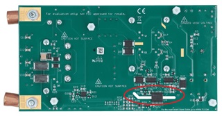

    Why is the PWRGND wire drawn under U4 on the evm board?
    Is electrical insulation involved?
    Do you have a picture of what you are mentioning?  Could you share it?
    I mention about the ditch circled in red.

    That cutout under the digital isolator separates the primary from the secondary.  It was done to meet creepage and clearance requirements.
