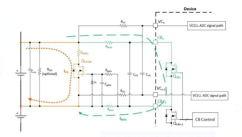

  1. Query: Dear TI team, We want to use external mosfet for balancing along with BQ796xx. could you please suggest us how to connect external mosfet to BQ796xx. Also please comment important points need to be taken care while using external mosfet. Kindly consider this as upmost high priority. Thank you!
  • Hello Shankar,
    Please see the image below for general format of external cell balancing circuitry.  Some additional notes for external balancing are as follows:
    • We recommend using a zener diode instead of a regular diode in the D1 position.
    • Ensure that you place a CB capacitor from the highest CB pin to BAT for hotplug robustness.  This component is often overlooked.
    • Adjust the Rexbal resistor to fit your balancing current needs: Rexbal + (FET Rdson) = Vcell / (desired balancing current in A)
    • Please use care when selecting the external FET.  Be especially mindful of the FET threshold voltage (Vgsth) and drive voltage from gate to source.  If the Vgsth of the FET selected is too high or too low, this can lead to either no FET turn on, or accidental FET turn on, respectively.
    • If the cell balancing capacitor value is too high, this can lead to accidental FET turn on if the FET Vgsth is low.  If the normal 0.47 uF Ccb value is causing issues in simulation, consider switching to a Ccb value of 4.7 nF.

    As illustrated in below image the top and the bottom cells are being balanced. Due to the cell-balancing bias, the middle internal switch M2 is seeing a higher Vds, which may exceed the maximum Vds it can sustain.

    1) No, you cannot balance all cells at the same time.  A maximum of 8 cells can be balancing at any given time.  Please see section 9.3.3.1.2 in the BQ79616 datasheet for more information.
    2)Yes, you can balance consecutive cells, but only 2, not 3.  For example, simultaneously enabling the FETs for 1, 2, 4, 5, 7, 10, 12, and 14 is valid, but simultaneously enabling the FETs for 1, 2, and 3 is invalid.  Please see section 9.3.3.1.2 in the BQ79616 datasheet for more information.  Please note that this applies to internal FETs, not external FETs.
    3)
    • Rgate is determined by the inrush current you desire at the gate of your FET.
    • Rbias is determined by how much current you want flowing through the internal FET, and what you want for your Vgsth value.
      • To maximize Vgsth, make Rbias greater.  To avoid choking current through the internal FET, make the bias resistor smaller.
      • This principle is due to the internal FET Rdson and bias resistors forming a voltage divider circuit.  Essentially: Vgs = Vcell ((Rbias / (2*Rbias + Rdsoninternal)).  If the Rbias resistance is increased, then the effect of the internal FET Rdson is minimized, leading to a higher Vgs votlage.
      • You could start with an Rbias resistance of 1 kOhm, then vary the resistance up or down to meet system needs based on the circuit simulation you create.
    4)  The Vds for the internal MOSFETs will be okay.  Just ensure that you do not exceed the voltage specs listed for the CB pins in the BQ79616 datasheet.

    When the adjacent internal FETs M1 and M2 are turned on, no current is flowing through Rext2 because Ibias through M1 and M2 cancel at
    Rext2; therefore, Q2 remains off even when the internal switch M2 is enabled.
    2) Can we turn ON two - three or more adjacent external mosfet at the same time?
    For example:
    As illustrated in Figure, the top and the bottom cells are being balanced. Due to the cell-balancing bias, the middle
    Thank you!
  • Hi Shankar,
    My apologies for confusion before. The BQ79616 does allow for adjacent cell balancing with internal FETs, but you are correct that you should not balance adjacent cells for external cell balancing.  It will cause FET turn on issues.  You can still balance up to 8 cells with external FETs--just not adjacent cells.
    To confirm your questions point by point:
    1) Yes, you can turn on balancing for up to 8 cells with external FETs, but you CANNOT balance adjacent cells with external FETs.
    2) You are correct that cell balancing will cause higher voltages across the internal FETs than would otherwise occur.  This increase in voltage should not exceed 2*Vcell, however, which should be well below the abs max spec in the BQ79616 datasheet.  Is there a particular voltage value you were expecting that was estimated to exceed the datasheet specifications?
