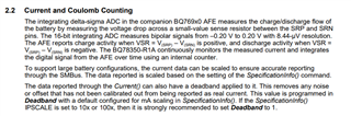

    The BQ76940 will sense positive or negative current through the sense resistor. Then, this current will be read from the BQ78350. The BQ78350 has a Fuel Gauge Operating algorithm which will detect charging, relax, and discharging depending on the current value obtained from BQ76940. You can reference to section 9.1.2 Fuel Gauge Operating Modes in the Technical Reference Manual.
    Also, in Section 2.2  Current and Coulomb Counting. The BQ769x0 AFE is the BQ76940 in this case.
    Note: The BQ76940 is a monitor and current sensing device and needs the interaction of an MCU. In this case, the MCU is the BQ78350 which is also a gauge.
