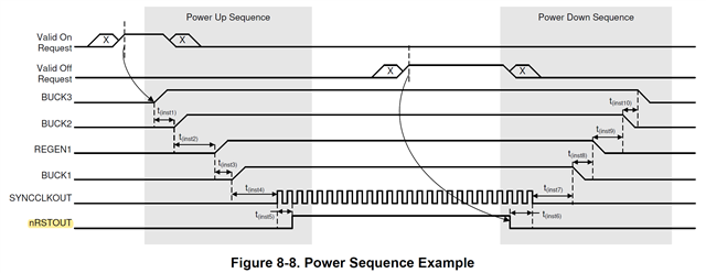

LP8764-Q1: Does WD LONG WINDOW START if Enable is de asserted
Part Number: LP8764-Q1
I am using GPIO4 as an active high enable to sequence the rails and go to active state.
If the Watchdog is enabled in NVM, Does the long window start automatically when the NVM finish loading, even though the enable pin (GPIO4 in this case) is held de asserted ?
