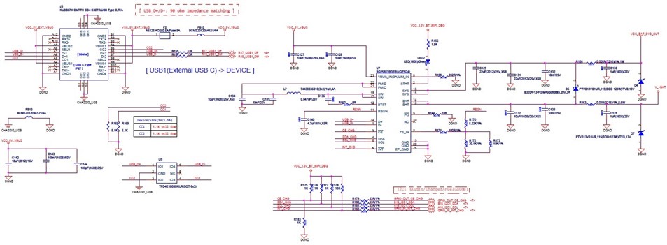

The customer applied the BQ25883 and created the circuit diagram as follows.
Q. Please review the circuit diagram below.
I know that BQ25883 can operate Vsys and BAT charging simultaneously.
However, when checking the EVM, simultaneous operation is being performed, but the customer's product operates as follows.
- BAT charging is not possible when using Vsys.
- If Vsys is not used, BAT is charged.
Please check what could be the cause of the above behavior.
If a separate setting is required for simultaneous operation, please advise on that part.
Please let us know if you have any information needed to check the cause of simultaneous operation not working.

  • Hi MJ,
    The SYS pin is the output of the boost converter and the battery is another load off of SYS, connected in parallel by the BATFET.   If the input power (VBUS*InputCurrentLimit) is high enough, then both SYS load and battery get power.  If not, the SYS load takes all the input power and, potentially, the battery must supplement the SYS load.  So, the question is, is the input power enough to supply both the SYS load and charge the battery?

    And now, the D+/D- port of the BQ25883 is connected to the charging port (type-c connector) in parallel with the MCU.
    How will this affect you?
    Is it a correct circuit to share the same D+/D- port as the MCU?
    Please confirm this part as well.

  • Hi MJ,
    The MCU can't use the D+/D- lines for the first 2 seconds after power up.  The D+/D- lines may be setting the charger's input current limit lower than the 2A or 3A source.  A register dump would be helpful.

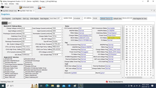

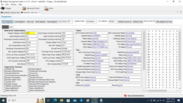

    The adapter is a 2A product, and the ICO current limit is set to 500mA.
    The following is a 2A product with the same specification adapter, but the ICO current limit is set to 2300mA.
    The question arises as to what difference causes the setting to be different.

    Please review Register dump.

    With ICO enabled, if the charger's input current causes the voltage at VBUS to droop to VINDPM, the charger automatically reduces input current to prevent entering VINDPM again.  The 500mA is the default value before the ICO algorithm completes. In the last screen print, the charger is showing that it is in IINDPM which means the SYS current is taking all of the input power and not leaving any power to charge the battery.
