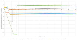

Having programmed these parameters if I do a full capacity discharge at 54A at room temperature, the gauge tracks well until it gets towards the end and then never drops below 6%.
Looking at it in more detail, the value of Pending EDV seems to fluctuate wildly and the battery only just flags EDV2 before the CUV point is hit (CUV is set for 2700mV).
If I look at my original calibration capture for room temp and calculate the voltages corresponding to 7%, 3% and 0% I get 3009, 2940 and 2830 from the high rate and  3156, 3037 and 2797 from the high rate.
As my test discharge is between the two rates I would therefore expect the CEDV values to sit somewhere between these (ie the compensated EDV2 would be somewhere between 3009 and 3156).
You can see on this graph that Pending EDV (Yellow) is way outside this range with the EDV2 point being anywhere between 3100 and 2445.
So, any idea what is going on and how this can be improved (other than reverting to fixed EDV)?

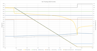

  • As a further update on this I have tried enabling fixed EDV0.
    This helps slightly, but mostly by masking the problem as it limits the CEDV range. It doesn't solve the underlying issue that the CEDV calculation is generating values that are clearly way out. TI are obviously very coy about disclosing the detail of the CEDV calculation, which would be fine if it actually worked or there was some way to see how to optimise the parameters beyond just using GPC.
    I've updated the original graph and added a calculated RSOC as well as the temperature. You can see how the Pending EDV tracks with the rising stack temperature through the second half of the discharge, but there is clearly more than temperature having an effect here (Note I also flipped the way that I was plotting the flags along the way as well compared to my original post).
    With Fixed EDV0 I now get the three EDV flags just about sequencing correctly, but too late which results in the plateau region in RSOC, although it does now at least hit 0%:

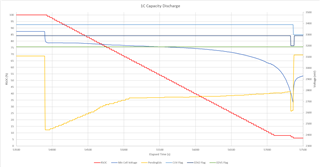

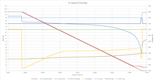

    After updating the CEDV coefficients I have reset my CUV value back to 2700mV and run some test cycles.
    On the second full cycle I have examined the discharge to see how the CEDV is doing.
    When the discharge starts, PendingEDV drops to 2640mV - given that I have set CellTermV to 2800, why is CEDV returning values out of range?
    As the discharge proceeds, PendingEDV rises slowly, the shape of the curve closely follows the temperature as the stack warms through the discharge.
    The RSOC value tracks down and then sticks at 8% (presumably because EDV2 is never reached although BatteryLow % is set at 7%)
    The stack then reaches the CUV cut-off point before reaching EDV2, so none of the EDV flags get set.
    The graph of this is shown below.
    So I'm still stuck with my original problem that CEDV just does not work even under benign conditions that are within the envelope of the learning cycles and I've wasted a load more time without getting any improvement at all.
    Why does CEDV not work?

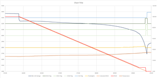

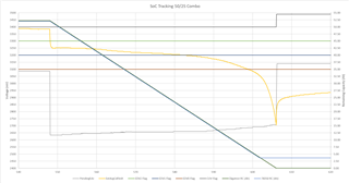

    In the meantime I have created a set of fixed EDV points aiming to reduce the error in the more likely discharge scenarios.
     I have then run some characterisation on these to see how it looks when I vary the rate and the temperature.
    You can see how at low temperature / high rate, where the voltage is supressed, EDV2 is hit early causing the SoC to jump to match the Battery Low % value that corresponds to EDV2.
    This is the sort of scenario where I would expect CEDV to improve matters, but that assumes that the CEDV algorithm can come up with a reasonable set of parameters in the first place.
