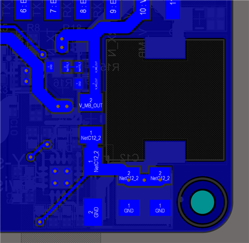

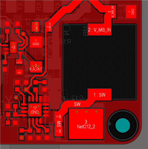

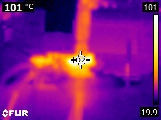

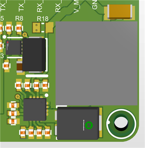

  • Hi Niklas,
    Monday was a holiday here in Norway also, so no worries.
    I am attaching the layout. Most of the components are on the top side, with the output capacitors and some filtering on the bottom. I agree it is not the best layout in terms of heat dissipation, but there are some size constraints to the design.
    I am also attaching some thermal images (top view of the inductor and LM5157, side view of the diode) and the output trace when the instability occurs. In this case there is a heatsink placed on top of the diode. Without the heatsink, the frequency would increase gradually until the switching shuts off completely, the output goes down to Vin, and the diode goes into thermal runaway and reaches 250+ degrees.
    Boris
  • Hi Boris,
    Thanks for sending the layout pictures.
    Here are the comment I have on the layout:
    - Current path traces of the power stage are a bit narrow (especially the wire to the inductor)
    It is recommended to connect the power stage components with copper polygons, instead of wire traces
    - Larger GND areas
    The GND area below the diode is rather small and connected the the other layers with only a few vias
    Please make sure the GND areas are as large as possible
    - Full circuit very close the PCB edge
    This will limit the heat sink by a large amount.
    If possible, please move the hot components a bit more into the center of the board, so there is more copper in more directions.
    Niklas

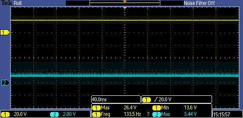

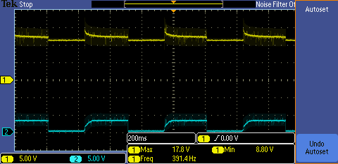

    To summarise the behaviour, when the output begins to flicker, the frequency of the flickering increases until the output drops to Vin and the diode goes into thermal runaway (250C+). If the diode has a heatsink, then the flicker frequency remains the same for a constant load. Increasing the load causes the flicker frequency to increase, but still remains stable.
    I hope this information is of use.
    Kind regards,
    Boris
    Output and FBOutput and SS

  • Hi Boris,
    based on your thermal images it looks like the Diode is heating up much more then expected.
    Base on my math the RMS in the diode (Vin:12V / Vout:24V Iload: 2A) should be ~ 3A. With a voltage drop of 0.3V this would give a loss of ~ 1W and the temp. increase with the land pattern used should be less but increasing the copper area for the diode to spread the heat would be good as well.
    Can you please confirm that the large heating is coming form the Diode only. I am not sure about the thermal image and the component references.
    It would be good if you can measure the inductor current to ensure this is behaving as expected and no saturation effects are happening.
