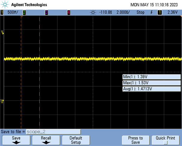

  • Hi Rowan !
    1. Could you pls help check whether the device is switching when 1.8V on P3 is existing? It is better to probe the waveform of SW3 with 2us/div.
    2. Could you probe the waveform of ENSW1-4, When P4 is enable and p1-3 is disable and P3 show 1.8V.
    3. Is this device programmed by you? I mean that did you change the internal configuration by PMBUS?
    4. Could you confirm that all of your board has the same issue or some boards have, other's don't have?
    Shuai
  • Hi Shuai,
    Thanks for the response. See answers below

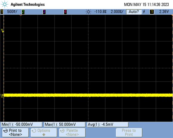

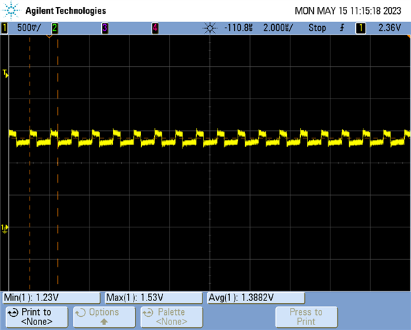

    1. SW3 is not switching. It looks like the 1.8V (which is actually somewhere between 1.4-1.9V on different devices) is supplied directly from SW3.
    SW3 when only p4 enabled

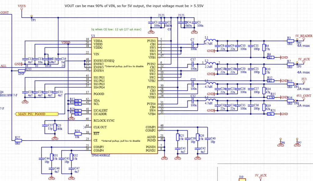

    2. ENSW 1-3 disabled:
    ENSW1-3 disabled
    ENSW4 enabled:
    ENSW4 enabled
    3. No. The I2C bus is not connected
    4. Yes, i check 10 boards. All having this issue. Although the voltage is different between the devices. In range of 1.4-1.9V.

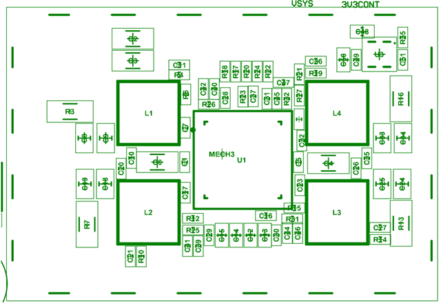

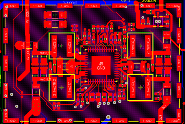

  • Hi Rowan!
    It is possible related to layout. Because I see that the ENSW4 be heavily coupled. (You can see some pulse waveform which looks like SW coupling)Could you pls provide the layout to review?
    Shuai
  • ENSW4 is floating (relying on the internal pull up)
    Are screenhots below oke for you to review?
  • I tried connecting the ENSW4 to VDDD (3.3) to make sure the ENSW4 has a good enable signal. But this did not solve the problem on SW3.
  • Hi Rowan!
    1. Just roughly take a look by screenshot, I only find there some signal trace is too close to the inductor.
    Could you send the whole Altuim designer file for details?

  • Hi Shuai,
    We found the problem, or actually a combination of problems which made is a bit harder to find.
    At the end it was, as we initially expected, a leakage voltage from somewhere else on our board. But apparently our switcher chip on which we where measuring was also damaged (probably due to our measurements).and was also supplying around 1,4V on SW3. which did confuse us in getting to the right solution.
    Thanks for your help.
