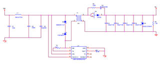

Hi Kakarla,
Sorry to hear that your design is running into issues. Can you provide your schematic, layout, and any waveforms of the start-up, and steady-state (SW, VIN, VOUT, and SS) to start off?
Richard
This is my schematic & transformer is using coilcraft make i.e., ZA9671-BED
turns ration is 3:1
kindly do needful
Hi Kakarla,
There's nothing about the schematic that stands out wrong to me. Do you have any waveforms to share, or a bit more to describe in what manner of how the LM25184 failed?
Richard
I am loading on output side with 10mA of resistive load then the IC is failed.
Input side high current drawn and out voltage is not getting after loading.
IC over heated after removing the load and high current drawn on input side(24VDC).
