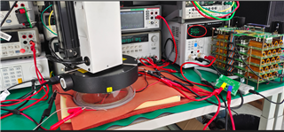

  • Hi  Marcello,
    I duplicate same phenomenon as your side with Freeze spray. But it is ok with thermostream even the temperature is -40. Bench test as attched picture.
    So, i expect the root cause is the condensed water droplets during the temperature rise, it will cause the impedance between the pins of the device to decrease.

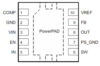

    Pin functions of TPS63700.
    Because the impedance of Pin OUT and FB decease, it will be some current flow from FB to Out and make the output voltage decrease finally.
    I tried to keep the device isolated with air during Freeze spray used, but our lab is lack of professional tools to do this, is it possible you can do this in your lab to confirm?

  • Interesting! It might be easier to seal the chip; if it is only pins 8 and 9  that are the problem I can put a drop of sealant to cover those pads on that area of the chip so moisture cannot get in. However the problem was first reported when we tested our system in a chamber (i.e ., not using freeze spray) so even if a sealant solves the problem I dont know that this is a viable solution (that we have to seal the cct. Also there should not be much condensation happening in our chamber but I will ask for details on how our chamber is operated.
  • Hi  Marcello,
    Thanks, hope this phenomenon will gone with sealed chip.
    But, i would like suggest you can seal the whole chip first, because i am not sure the root cause is Pins 8 and 9, just suspects.Sweat smile

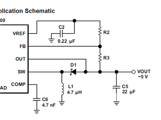

  • By the way I don't understand what VOUT (sense pin) does or why it is necessary. The block diagram of the D.S. shows it goes to the 'Control logic' block but what effect does it have there? The FB pin (and its external resistor divider) are what is used to set the output voltage anyway.
  • Hi  Marcello,
    A simple way to understand is that you can consider there is resister in parallel with up resister of divider(the resister connect from out to FB),  because of the water droplets during temperature rising.

  • I re-tested the same eval board with the chip 'sealed' (I used the  Cyanoacrylate) and found that sealing the chip solves the problem: the output is now stable with freeze spray applied, to -20C (and lower). But the test department here says there is no condensation in the chamber; so there is anomaly here; if there is no condensation in the chamber then the chip should not have failed. We will have to further investigate the situation with the chamber.

    The question I raised about the function of the VOUT pin and how it affects the control block still remains. How does this pin affect the control block?
  • Hi  Marcello,
    According the block and the current balance at FB node, you can got an equation as below.
    Vref/R2=-Vout/R3+Ileakage.
    Here, leakage current means the current caused by the condensation. during the rising edge of ambient temperature, the leakage current becomes bigger one. Then Vout drops.
