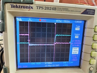

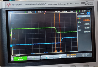

I am using UCC21710-Q1 driver IC for SiC MOSFET (C3M0040120D). 50kHz signal is generated with 160ns dead time using DSP board. The output from the DSP card is given below with 160ns dead-time.

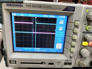

Same signal is given to input to the Driver board through FRC cable and the output of the driver is given below
I have observed that there is Dead-time difference of 350ns. Can you please suggest, why this extra dead-time is adding to gate pulses. I have added RC (R=120R and C=56pF) filter at the input of the driver IC as per the datasheet. The driver circuit is given below for your reference

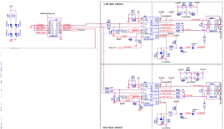

    Thank you for the reply. Yes, I am using two gate drivers, one for Top-switch (Higher-side) and second one is for Bottom switch (Lower-side). The schematic is given below
    IN+ and IN- signals are square wave pulses with dead time 160ns (Fig can be available in my previous post)

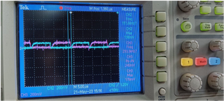

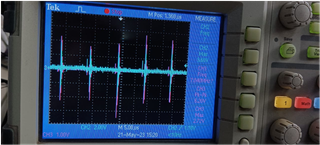

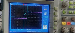

    Thank you for the reply. I have taken the OC pin signal for with and without MOSFET connections. I also observed that there is delay in same input (LS_in or HS_in) and output signals (LS_out or HS_out) of the driver. I have added my observations and figures below
    Driver Dead-time analysis
    1. OC signal without MOSFET connection (in CON1, PIN-1 and PIN-2 shorted)
    CH2: OC pin of UT3
    CH3: OC pin of UT2
    1. OC signal with MOSFET connection
    CH2: OC pin of UT3
    CH3: OC pin of UT2
     I also observed that there is a delay in the input and output of the same signal and are given below

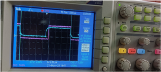

    1. LS-PWM_IN Input ( at JT1) and output of the driver (at CON1) without connecting MOSFET
    Observed that dead-time is difference of ON-time delay and OFF-time delay i.e., 760ns
    1. HS-PWM_IN Input ( at JT1) and output of the driver (at CON1) without connecting MOSFET
    Same delay for HS_PWM signal.

    I see. Thanks for the additional information. Can you redo the deadtime measurements but measure the output close to the gate driver? This will give us more accuracy.
    Nancy

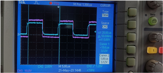

    Thank you for your inputs. I have solved the dead-time issue. I found that ground connection is missing in the control card. The input and output waveforms are given below
    INPUT pulses Input pulses with dead-time 340ns
    OUT_pulses OUTPUT pulses with dead-time 440ns
    If I am not wrong this 100ns is the propagation delay of IC.

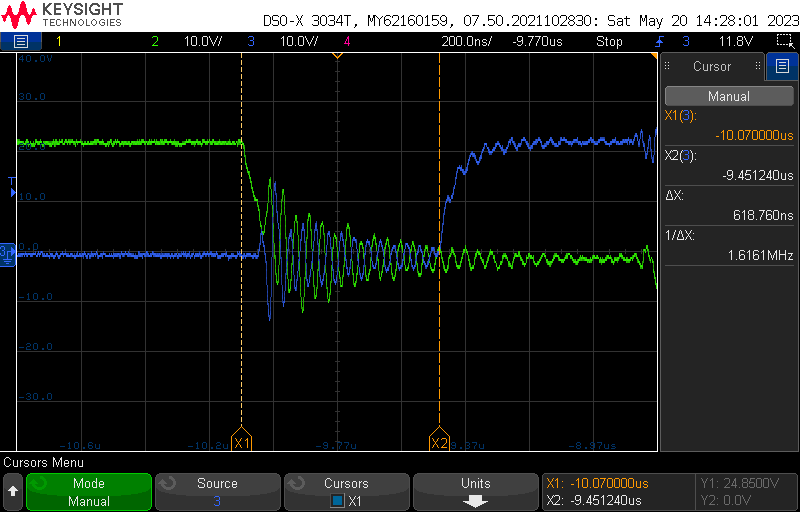

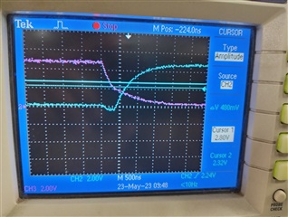

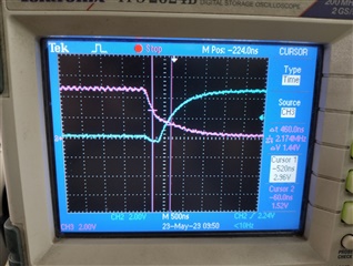

    Thank you for your reply. I have measured the input and output close to the gate driver IC. The waveforms are given
    As per your calculations (for Vcc 3.3V),  here, Vcc is 5V and I placed the cursers at the threshold voltages of the IN+ which would be 2.8V going HIGH and 2.32V going LOW, same is given below
    The dead-time around 460ns. But my input signal from the DSP is 340ns, extra 120ns is adding.
    1)Is this extra dead-time is because of RC filter? can you please clarify this. How to design the RC filter for this IC,
    2)Can I connect filter capacitor across IN+ (pin10) and IN-(pin11) to limit the noise, if yes, what value is best?
    the out signal at the IC pins are given below (without MOSFET)
    The dead-time around 500ns. around 40ns dead is adding by IC maybe because of propagation delay.

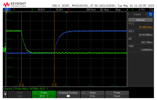

    When I connect actual MOSFET leg, the dead time is same but oscillations are produced. same waveform (Vgs of two mosfets) is given below
    These oscillations are more when I load (9000W) the converter. the corresponding Vgs signals are given below
    3) Can you please tell me what parameters effecting this oscillations, Is this because of Ron and Roff?,
    I have selected same (10 Ohms) for Ron and Roff.

  • Hi Umamaheswararao,
    You are correct. Looking at the waveforms you can see your DSP changing states from ON to OFF state in one signal and OFF to ON state in the other signal with 340ns time difference, but from the thresholds(2.8V and 2.3V) there's about 460ns dead-time. This is due to the RC input to the gate driver. The RC filter increases the input signal robustness under noisy conditions. The added delay due to the RC must be included in your analysis to make sure you have the targeted dead-time per your requirements.
    4)What is the best combination of Ron and Roff.
    One of the factors for gate oscillations is the parasitic inductance in your gate loop. The parasitic inductance can be reduced in the layout by minimizing the physical distance of the gate driver output to the GATE of the MOSFET, using wide traces for the overall gate loop (driver output and return path). Parasitic inductance can also de damped by increasing the gate resistor value, but this can also have negative impacts on your switching speed. A ferrite bead can also be used in the gate path to reduce the high frequency noise. You can refer to the below links for further information on gate ringing mitigation methods:

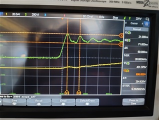

    Thank you for the suggestion, I have used 200Ω, 100MHz ferrite bead with external gate resistor (15Ω). Now, gate signals noise is reduced.
    But, Vgs oscillations are 20Mhz during ON and OFF and same are observed in primary voltage of the transformer and the corresponding waveform is given below
    Seems these oscillation are typical in these high power application. The main power loop path ringing is also affected by the parasitic inductance in the design. Best way to try to reduce this is by physically reducing the power loop path in the system.
