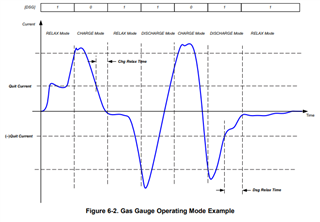

    It means relax state, so if the current is below the Quit Current threshold for the corresponding Chg/Dsg Relax Time then it will be in relax state. We have a helpful illustration in the TRM:
    There are two different modes to allow cell balancing, either in sleep or in relax, so the bits give you configurability to choose which modes you would allow balancing to occur. Relax mode is fairly easy to enter, sleep mode will be more difficult in general, depending on the setting this can change. Cell balancing won't start until an OCV is taken so it may not start balancing for some time while in RELAX mode.
