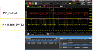

We used 1212 and 1111 power solution for TDA4 soc. The AVS output of 1212 is PFM mode after boot successfully.

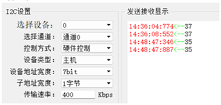

Now we wanted to change AVS to PWM mode, and rewrote bit1/bit2 in 0x04 (in 1212) in SBL stage.
After tested, we found that that register is right, but the waveform isn't correct.
we read the register by the iic tooling.
The AVS operation is still held in PFW mode.

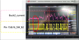

  • Hello Ryan,
    From your scope shot, if the yellow represents load current or inductor current, the AVS rail is reacting to a load transient event. During some load transient events, the switch node will turn off temporarily to drain the output cap. This will appear similar to PFM. To confirm the the switch node in FPWM mode, the load needs to be light (less than 300mA) and relatively steady.
    If you capture the AVS signal as well, you should see the voltage being a little on the high side right before the SW node turns off.

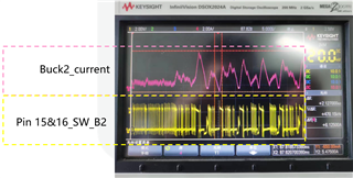

  • Hi Michael,
    Update the testing result:
    Buck2-current:tested by current probe
    Pin 15&16-sw-b2: voltage value of the Pin 15&16(1212), and in front of the inductor
    This is same as the testing point which was provided last time.
    And what do you mean ' the voltage being a little on the high side right before the SW node turns off' ?
    could you help to explain it in detail?
  • Hello Ryan,
    After a sudden load drop, the output voltage will increase slightly. When this happens, the Buck's control loop will try to drain some of the charge from the output cap by turning off the switch node. FPWM and Forced Multi-phase mode are easiest to distinguish from PFM/Auto mode at light steady state load scenarios. The left side of your scope shot provides a good example. The BUCK2 current relatively low, and SW is keeping a pretty steady frequency.

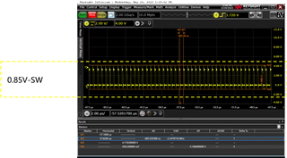

    Please refer to the PIC as below, the peak-peak value of AVS more than 60mV while the internal switch turned off.
    Is this a reasonable value(output ripple)?
    For the steady frequency in SW side, it is always changing.
    I marked the frequency in the PIC as below, the value isn't kept  2.2MHz which is setting by register.
    And I captured the SW waveform of 0.85V in 1212, This is steady frequency what I think is right.

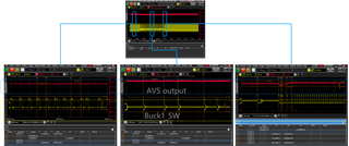

  • Hi Michael,
    Update AVS output under low loading.
    After testing, the AVS is still under PFM mode while only Buck1 running. But we have rewrote the register( BUCK1_CTRL Register=0x37) .And the 1212 shall run in PWM operation mode.Is there other operation before and after writing register ?
    Please refer to the PIC as below, is that correct?

  • Is this a reasonable value(output ripple)?
    This is incredibly high output ripple. This is a sign that there isn't enough output capacitance or the FB lines were not routed correctly.
    The BUCK is experiencing multiple load transient events one after another which doesn't allow the SW to settle. It takes about 20-30us for SW to settle. From your earlier plots that include current, the large load transient events are less than 5us apart.

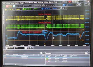

  • Can you provide a scope shot with 3 channels showing load current, AVS output voltage, and the SW node? It appears to be PWM mode in the left and right side for sure.

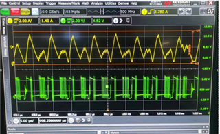

  • Hi Michael,
    Please refer to PICs as below,
    Bcuk1-heavy-Loading: AVS voltage, current, SW Pin
    Bcuk1-Light-Loading: AVS voltage, current, SW Pin

  • Hello Ryan,
    In the scope capture, the PMIC appears to behave as expected in regards to the SW pin and FPWM mode. Before sending the SCH and PCB files, can you confirm the FB_B1 and FB_B2 are routed differentially to the point of load near the processor?

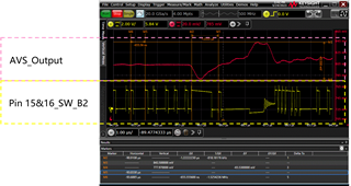

  • Hi Michael,
    We also tested Buck1_SW in the EVM-J721EXSOMXEVM, please refer to the PIC as below:
    The phenomenon is the same as ours. how to explain this.

  • Large rises and falls in inductor current, signal a load transient event. See circled areas below as example:
    After a load transient event, the buck needs about 16-20us of settle back to normal.
  • We also tested Buck1_SW in the EVM-J721EXSOMXEVM, please refer to the PIC as below:
    Looking at the switch node alone, does not provide enough information. You must look at the Vout for sudden changes indicative of a load transient.
  • Hi Michael,
    Here's buck scope in the EVM. It looks quite similar as ours.

  • Ryan,
    Your scope shots show normal PMIC behavior to load transient events.
    When the load is relatively steady, the buck will switch at a Fsw. When a load transient event cause the Vout to suddenly rise or fall, the buck's control loop will react by temporarily switching faster or slower until Vout is back on target. This is normal behavior.
