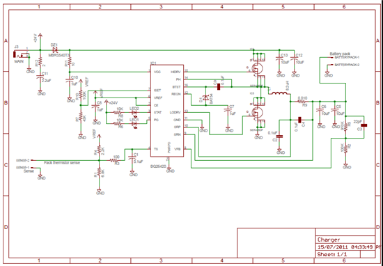

i have used the application note of bq24620 and built the pcb for charger. Charger is for VIN=28V, BAT=5-cell Li-Phosphate, Icharge=4A, Ipre-charge=0.125A, Iterm=0.3A.
i have started testing the circuit and observed the STAT and PG led are Glowing, without connecting the Batteries to it. According to datasheet, STAT led should Blink at 0.5hz freq, but it is constantly on.
i have measured the voltages of the Pins which are as follows:-

Schematic :
Please help me finding the problem, as i am clueless what is going wrong. PCB is verified w.r.t. to schematic.
