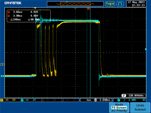

We are using a UCC21755-Q1 gate drive to run two SiC MOSFET in parallel, the Rgon=15ohm for each one of them, and no capacitor has been used in the gate drive path. As soon as we apply a small amount of voltage across the Vds (like 4V), the gate driver waveform changes to the below waveform:
The blue one is the input signal of the gate driver, and the yellow one is Vgs.

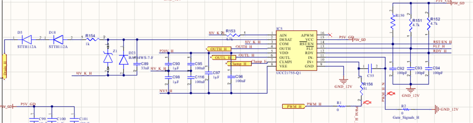

So, could you please help us with this issue? Do you think it has something to do with the gare drive itself, or is it related to a big parasitic inductance in the gate loop?
  • Hi Erfan,
    The UCC21755 has an overcurrent protection pin (DESAT) that measures the voltage across the switch and then will turn off the output if it detects a voltage above a certain threshold. It seems that this circuit is not yet set up correctly. Can you share your gate driver circuit schematic? I can help you to adjust it. You can also use a version of this device with a lower threshold (OC) for a SiC Fet, such as UCC21710.

    Sure:
    It can be the Desat, but if desat acts and turns off the gate driver, will the gate driver turn on itself automatically? I connected the RST/EN pin to 3.3V.

    In the first image, there is a deep spike on the blue input before the output starts to pulse low. Could the problem be with VCC decoupling? Is there another switch in the circuit that is switching at that time?
    I do not know what to make of the second waveform.

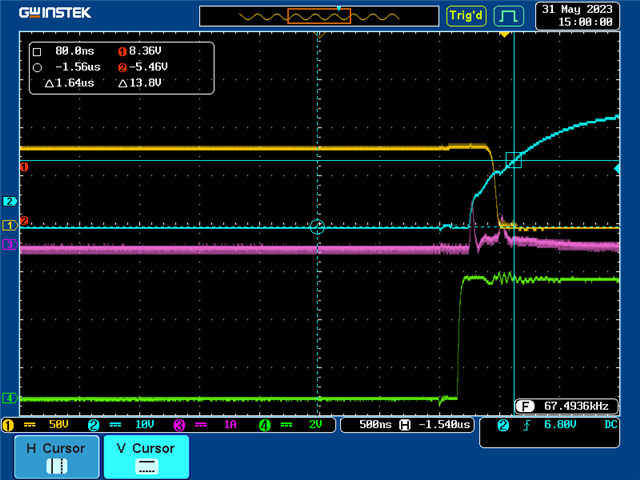

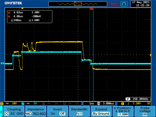

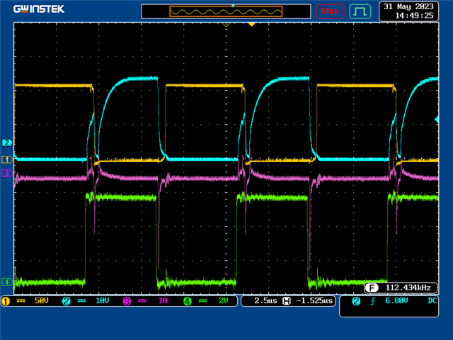

    If you could see the attached photo, the blue waveform is (Vgs), the yellow one is (VDG, not VDS), the pink one is (Gate current), and the green one is (Input of the Gate driver). As can be seen, frequently, the gate drivers turn off, and then on. Also, there is a 2nd glitch in the current. Plus, when this phenomenon occurs, there is a drift in the VDG's turn-off time, please second the attached 2nd and 3rd photos.  The desat is de-activated, so is there anything that can push the gate driver to switch to the OUTL path? As the input is not switching off, what else can push the gate driver to switch it to OUTL?
    Do you think what is the issue here? Noise? PSU voltage? or a fast dv/dt? or a latching or slew rate?
    Kind Regards,
    Erfan
