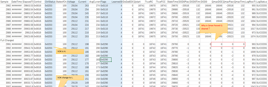

Hi them.
We've been trying to learn the BQ34Z100-G1 for a few weeks now with no success.
I reviewed the settings and ran it, and I was able to detect full charge by the taper current.
I was able to confirm that the VOK bit changed from H to L during relax mode.
However, the UpdateStatus still 04 and the learning could not be completed.
After some investigation, QmaxPassedQ and QmaxTime QmaxDOD0 are cleared to 0 when full charge is detected (FC=H).
Why is this occurred?
We understand ImpedanceTrack clears it when it integrates QmaxPassedQ.
I need some advice to make it successful.
We believe that it should be held while VOK is high.Because it is integrated when VOK is L.

  •     The Qmax supposed to update at VCT, can you upload the srec file you used for learning? I need to check all parameters
  • Hi Steven.
    Here is the srec file we are using for learning. I would like to know what the cause is.
    8475.0100_0_16-bq34z100G1.srec.txt
  •     I think I finally found the cause of your issue, what you observed regarding QMaxPassedQ and DODPassedQ clear at full charge are as expected. VOK keep set at the same time is also normal, all these are expected behavior for for the cell with LiFePO4 chemistry.
       The issue is that you should not set Flash Update OK Cell Volt to 3838mVolt, which is too high for Qmax in dataflash to be updated, for LiFePO4 battery, this should be set lower than regular Li-ion Cell, I think even 2v shall be appropriate for your configuration of 8S1P
       Please also be noted that another parameter of CC Threshold is way too low to the capacity of the battery

  •      Such calculation will get the raw ADC reading, but this supposed not to be used to compare with actual value used in FW, please try using 2800 see if you can get Qmax updated by repeating the learning cycle.

  •     After aligning with the internal team, it is confirmed that the description in the datasheet is not correct, Flash Update OK Cell Voltage shall be the averaged cell voltage under which the flash update is allowed to happen.
       For LiFePO4 battery, the QMax update happens at the end of charge, i.e., VCT, once this happened, VOK is cleared briefly, but set again immediately, so what you are seeing is the VOK keeps setting during Qmax update, which is as expected.
