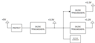

In TPS62A02DRLR datasheet, I see the following statement:
The TPS62A0x is designed to operate with an output capacitor of 10 μF to 47 μF, depending on the selected output voltage, as outlined in Table 9-3.
I would like to use TPS62A02DRLR to supply the voltage for and IC that requires multiple decoupling capacitors.  In total, that could represent around 500 uF.  Does the decoupling capacitors of my IC will affect the filtering cap on TPS62A0x DCDC.  If yes, what would be the maximum number of decoupling cap I could put on my IC?
