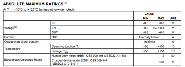

Hi Team,
We are using TLV7103318QDSERQ1 in one of our design. Can you please help us clarify that the absolute max value for the En pin is VIN + 0.3V.(VIN 0.3 is a typo).
Gireesh
Hi Team,
Gireesh
Hi Gireesh,
Yes the TLV710 devices abs max for the EN pin is VIN + 0.3V
John
