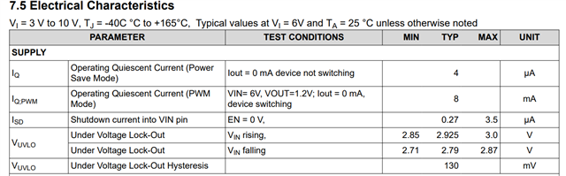

I had a query regarding the Quiescent Current of TPS62993-Q1.
As per our understanding, if device is in Forced PWM Mode, Quiescent Current is high.
If device is in Auto PWM Mode, and if Output Current is 0, Quiescent Current is ~4uA.
What will be the Quiescent Current if load current is ~1-2mA and ~10mA? i.e. Device is switching at light load output. Can we get any graph regarding the same or any related data?
This is because in our standby mode, the load current is in range of ~10mA, so we wanted to know what the quiescent current of the device would be.
