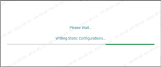

Hi Ishtiaque,
Yes, we have contacted with local sales representative.
Toady, we generated a NVM configuration(.bin file, Static configurations and PFSM), when using this configuration to Program Device, always on the interface below. Is there any problem with the static configurations?
Thanks!
Hi Ishtiaque,
Could you please give us the I2C/SPI SEL registers, address and value. We try to find the difference after change the IF from I2C to SPI:
SERIAL_IF_CONFIG——I2C_SPI_SEL——Value I2C:
"id": "I2C_SPI_SEL",
"value": "0",
"staticConfig": true,
"isTouched": true
SERIAL_IF_CONFIG——I2C_SPI_SEL——Value SPI:
"value": "1",
"isTouched": true
