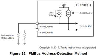

The problem is it is reading back wrong address from Digital fusion tool, we have set the address to 65 (Dec), different power cycles it gives different addresses, the set resistor values are correct.

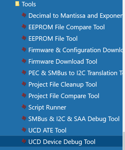

This is not a new design it is already in production. We are using Fusion Digital Power Designer Ver 7.9.1. Can using a different version of TI tool somehow corrupt the chip? If the manufacture house did not have the latest version of Fusion Digital Power Designer?
The Part No is UCD9090ARGZT and the TI fusion Tool version is 7.9.1
