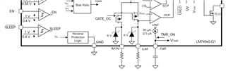

Hi.
I have a question about LM74900-Q1.
It is used under the following conditions of LM74900-Q1.
An application that receives battery voltage from a vehicle.
Overcurrent Limit = 11A / duration = 1ms
short Current = 20A / 5us
It is a situation where the battery voltage of a normal vehicle is received.
- I wonder how long the Overcurrent duration of the Load dump (LM74900) is generally set to in automotive application.
  We will set the general value first and then proceed with the board test later to find the optimal value.
  it can be set the TMR terminal by adding the appropriate capacitor between the GND.
