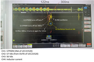

Hi Team,
My customer is using UCC21520 and meet some issues that need your help.
Issue:
Customer found Vds oscillation, measuring PWM from the DSP and it’s good. But if measuring at INA of UCC21520, found similar oscillation on INA. So, we guess the oscillation on Vds affects Vgs (OUTA) and then coupling back to INA.

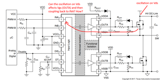

Questions:
1)Is the guess correct. If yes, How can the oscillation coupling back to INA?
2)What customer can do to eliminate the oscillation on INA? One proposal I think is add ferrite bead on Vgs.
