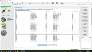

    I am trying to program the CHEM_ID by Selecting the Chemical ID from the Chemistry Database and clicking the Program Selected Chemistry but nothing is happening i tried several clicks on it and reinstalled the bqstudio and updated the chemistry version also. can you please guide me what is the procedure of changing the CHEM_ID.
  • Hello Rohit,
    Please share a full screenshot of the BQStudio chemistry page when you try to program the chem ID. There is most likely a small error noted on the bottom left of the window.
    You will not be able to change anything if the gauge is sealed or if the voltage is too low, the gauge prevents flash writes if voltage is too low.

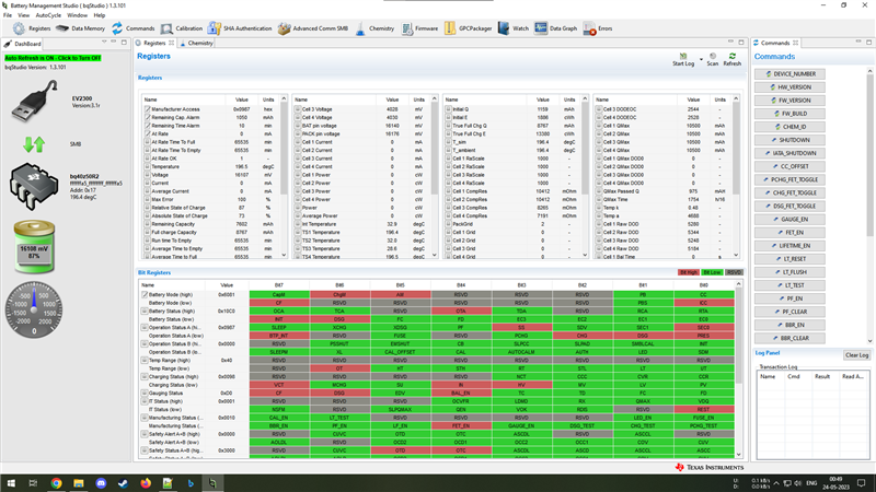

    Here is the screenshot of whole BQStudio of initial start:
    https://pasteboard.co/wT4x4nrrRT8V.png
    Here is the screenshot from chemistry and selecting the CHEM_ID and clicking Program Selected Chemistry button, unfortunately i dont receive any feedback or any kind of error from BQStudio or from windows also, after several clicks also it has no effect.
    https://pasteboard.co/Pe4M0W1cCxbb.png

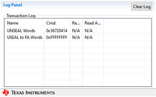

    I dont think gauge is sealed, just for your assurance i have send UNSEAL & UNSEAL_FULL_ACCESS commands screenshot attached below:
    Please guide me further
  • Hello Rohit,
    It looks like you are using an older BQStudio version, I would recommend using the TEST version for the most recent fixes and features.
    On your main register page it also looks like your device ID is all FF, which means you may have the communication in the wrong port. Make sure you have the SMB port attached. When you click the program selected chemistry nothing occurs?

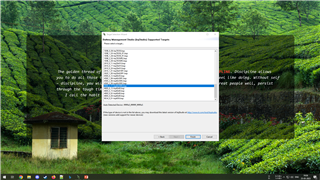

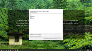

    As per your guidance i have installed the new beta version of BQStudio ver 1.3.121.
    My bms have 5pin output in following order: 1:(P-), 2: ID, 3:SMBD, 4:SMBC, 5:(P+) and have i am using EV2300 SMB ports to connect with bms.
    After Installing i have tired again to program the selected chemistry but nothing occurs as said earlier.

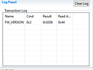

    I have attached few screenshot for your reference.
    Please guide me further, if we need to reset the gauge or update the firmware because i have two pieces of same bms and both are having same behavior and showing same as you can see in screenshot
  • Hello Rohit,
    The EV2300 is no longer supported on newer windows systems, we have some drivers which can get it working but they are not tested. Please use the EV2400 when communicating with the BQ40Z50 EVM. This may be causing communication issues.
    You can also see in the auto detected device session that the numbers are all ff's which indicates communication issues, not just for uploading the chem ID.
