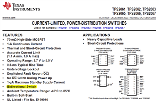

Hi - I'm using the (correction:) TPS2061CDBVT to control power to the USB OTG connector.
I can read/write to a USB stick (board in host mode), and read/write to a PC USB-CDC (board in device mode).
The board normally has its own power and is not powered from the PC.
However, a couple questions:
1) What happens if the board power is disconnected while it is connected to the PC?
Power flows happily from PC to board 5v, as the switch is bidirectional? Or???
2) What happens if the user plugs into the PC without first applying board power?
Thanks in advance!
Best Regards, Dave
PS: If Bad Things happen, what protection or alternate circuit should I use?

    The switch is designed to control power from IN to OUT.  That is, it's not meant to be bidirectional.  I have doubts TPS2061 will block reverse current since the datasheet doesn't make any claims to do so.  In a scenario where the board is unpowered but 5V is present on USB VBUS, the worst thing that could happen is current flows through the integrated FET's body diode, resulting in ~4.3 V on IN.
    It sounds like you are looking for is reverse current blocking.  There's a good app note on the subject here: https://www.ti.com/lit/an/slva730/slva730.pdf.  The most comparable device to TPS2061 with guaranteed reverse current protection is TPS2061C.  It will block reverse current whenever the switch is disabled, meaning IN pin will stay at 0V.

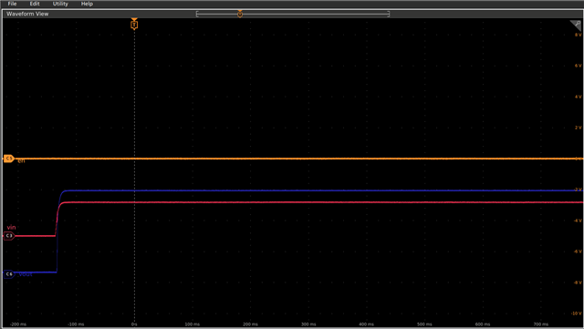

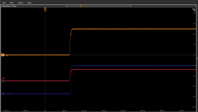

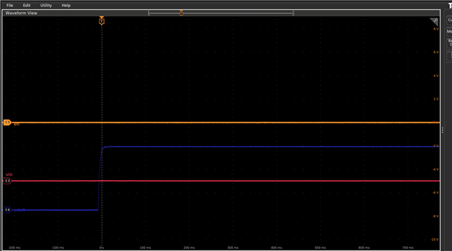

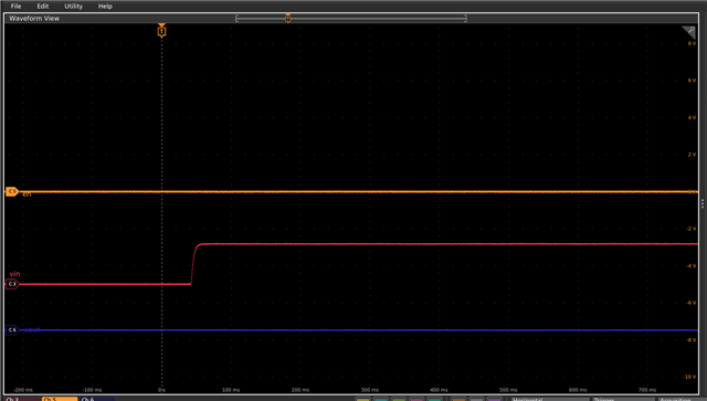

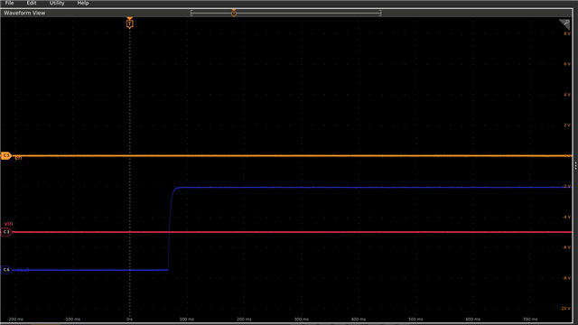

    Yes, when board power was disconnected, PC powered board until USB cable was unplugged.

    I use the TPS2061EVM and TPS2065CEVM(only EN high different  with TPS2061C), and when I input the voltage to the output, and measure the input pin voltage, it is 0, so it should not happen what you meet, so I guess it may have some other way that let the current go from output to input, could you please remove our device and check the input again?
    TPS2061:
    1, EN=low, and power on the input=5V, then output=5V
    2, EN=high, and power on the input=5V, then output=0V
    3, EN=low, and power on the output=5V, then input=0V.
    TPS2065C:
    1, EN=high, and power on input=5V, then output=5V,
    2, EN=low, power on input=5V, then output=0V
    3, EN=low, power on output=5V, then input=0V.
