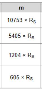

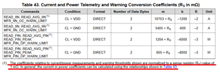

According to the datasheet, it is recommended to refer to the table below when calculating power or current.
Are there reference values for other sensor resistance values? Could you please provide m/b/R values for 3mohm, 5mohm, 10mohm sensor resistors?
