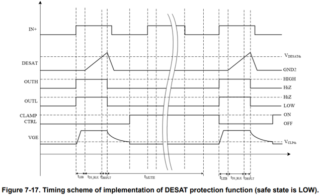

i find the following picture from datasheet about DESAT function.
i have a question about tleb. from my understanding, the begin of tleb is rise edge of OUTH as quick calculation tool shown(tdesatleb), am i right?
do we plan to describe/add delay between IN and OUTH in datasheet picture?
