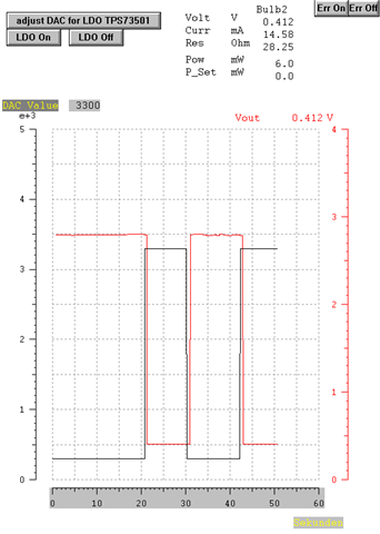

  • Customer feedback:
    The behavior does not change when C148 is removed. There are also no stability problems with >1000 PCB's, even if according to Data sheet should be a >3pF CFF. My 10pF should not be CFF, but reduce the noise at the VREF input. I could imagine that an increase in C148 will solve the "jump problem", because it will reduce the rate of change of VOUT, possibly at the expense of control stability. I will test. It sounds like the issue is with the speed that the VOUT is toggled. Exactly ! And it only affects a few PCB's. The SW makes this big DAC jump from about 1900 to 4000 only once, when calibrating the sensor. Never again afterwards. The DAC jumps are then < +500. For DAC jumps from large values to small values, everything is always OK, no matter how high the jump height is. With DAC in steps of 1000: Everything is OK VOUT does what it should, is also stable. DAC Value = 4095: = 3.0V at the DAC
    With DAC in step 4000: Voltage Vout goes to the supply voltage of 3.24V (instead of 0.2) and remains stable there. Nothing swings there. For DAC in steps of 2000 the same. Steps of 1500 work.
    Enable from High--> Low -< High : Then the voltage goes to the correct value of 0.2V
    At the moment, I cannot make measurements with an oscilloscope of the voltages. Next week I've the first option. The measurements are currently made with the AD converter on the board, which here can only measure the voltages Vout and IR_DAC with a resolution of 20ms. I suspect the classic latch-up effect, where a parasitic thyristor ignites by a positive spike at the VFB input. C148 is intended to reduce this spike. Why only 1-2% of ICs do this remains unclear. C148 =100nF Then DAC jumps go until 3000. After that, they are no longer reliable. But the noise of Vout is too big for me. 100nF will safely avoid the spikes on VFB. That speaks against my thyristor theory. Some ICs probably do not like large voltage changes to VFB in a short time. We first sort out the PCB's with this behavior and then strive for the SW solution, which limits the jump height.
