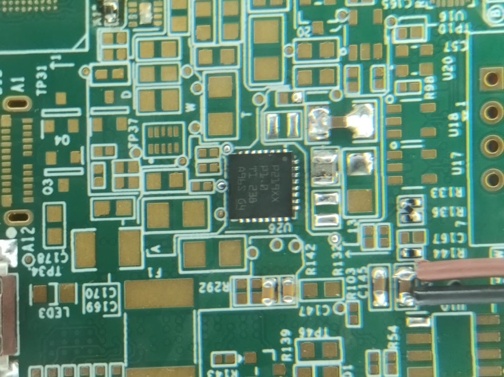

we are working on the "TPS6521904RHBR" to power up the AM6X processor with DDR4,we are unbale to power the processor due the PMIC is not working,
the following are the testing observations.
EN/PB/VSENSE-----is pullup with sw option (high 3.3V)
MODE/RESET-------is pullup(high 3.3V)
MODE/STBY-------is Pullup(high 3.3V)
GPIO2----------------is Pullup 10K
  we had observed the GPIO2 signal still LOW and PMIC output voltages all are in 0V,
as per the datasheet the marking of the device should be as shown in below
we are seeing marking P219XX on the device ,we have doubt on the NVM loading since we haven't observed GPIO2 High this first step for the power sequence of the PMIC.
please find the attached PMIC schematics. Kindly let me know any other information is required.

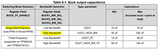

    • "P219XX" is a generic top marking used for pre-production samples. Once the TPS6521904 is released, then production material will have the top marking you saw on the data sheet.
    • All Buck converters on TPS6521904 are configured as quasi-fixed frequency and high bandwidth. This configuration requires a minimum of 30uF of local capacitance (47uF is typically used). Buck3 shows 14uF in the schematic (0.1uF+4.7uF+10uF).
    • LDO3/LDO4 share the same input pin and require a typical of 4.7uF on PVIN_LDO34
    • These are just observations but should not prevent the PMIC from powering up. Could you share a power up sequence showing the following signals:

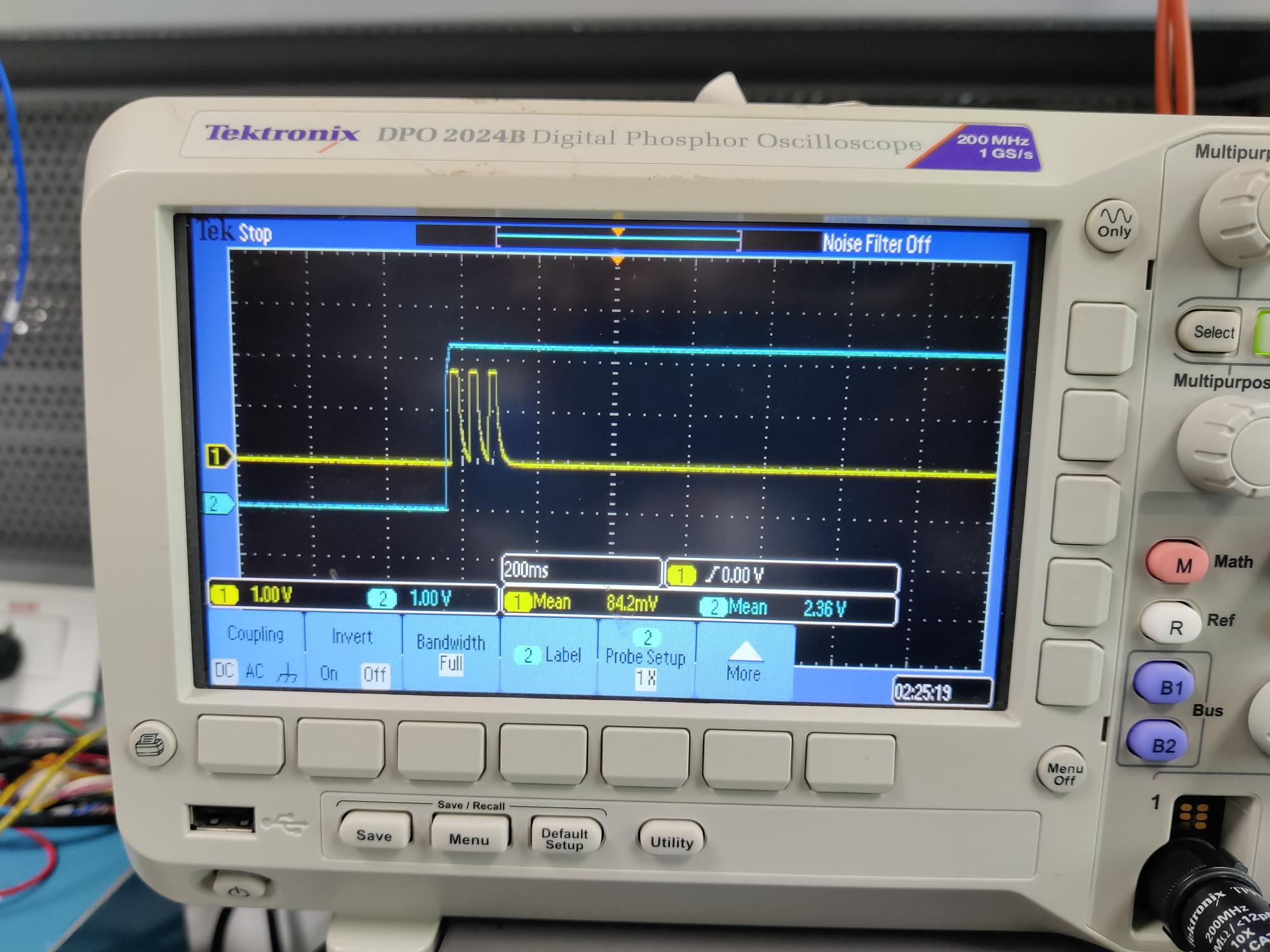

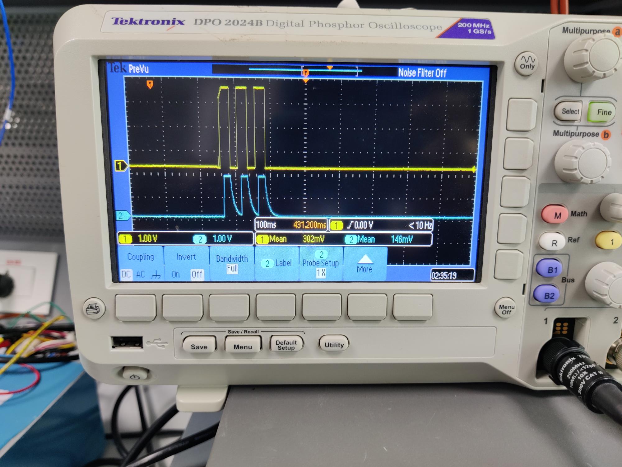

    thanks for the quick response, please find the below images for
    • VSYS (VCC_3.3V_EXT)
    • GPO2 (PMIC_TPS22965_EN)
    • Buck2 (DVVD_1.8V)
    • blue probe is VSYS and Yellow probe is GPO2
    yellow is GPO2 & Blue is Buck2 (DVVD_1.8V)
    Blue is Vsys & Yellow is Buck2 (DVVD_1.8V).
    the PMIC is trying to powerup and going to sleep mode.

    Thanks for sharing the scope captures! They show the PMIC shuts down its rails approximately 20ms after Buck2 is enabled. If we compare this data with the power-up sequence on the TRM (see page #8 at the link below), it matches the timing between Buck2 to nRSTOUT. Based on this, we can say the issue starts happening after the PMIC completes the power-up sequence, right after nRSTOUT goes high.
