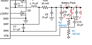

    Can you confirm that the leakage current is going into the IC itself (either VCC, SRN or SRP pins) and not through smaller sized (<499kohm) resistors at MPPSET and FB?  If so, then can you confirm that VREF and REGN are going to zero when the MPPSET is pulled low?  If so, then you may need to add the Schottky and extra cap as shown below:
    Jeff

  • Hi Jose,
    The app note was inspired by customer complaint.  Since we released it, we haven't had any more complaints.  As long as the IC MPPSET is placed in HiZ mode, the IC pins go high impedance and do not sink current (other than nA pin leakage).  The big concern is SRP/SRN.  So, for max safety, I recommend the Schottky diode on the output as a redundancy.
    Jeff

  • HI Jose,
    The real issue is that the body diode across the Q1 high side FET provide a path from the battery to VCC.  If panel output voltage is above V(BAT) but below VMP, the VCC can draw in the mA range as if charge was disabled.  There is some leakage going into SRN too but it is in the uA range.
    VMP accuracy below is   but ignores resistor tolerance.  I assume you are using a second resistor divider off the panel and using the ADC to measure that voltage?  If so, worst case  +/-0.6% +/- 1% resistor tolerance, should be good enough.
    Jeff
