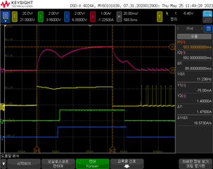

  • Hi, Elizabeth
    The values you mentioned are consistent with what I intended, excluding Duty. I designed the duty to be around 30%.

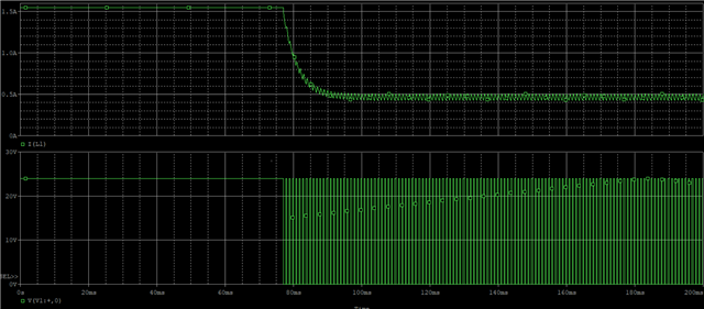

    I will provide more details about the parameters. This waveform is obtained through simulation. Since the simulation was pefrormed using only simple R and L components, we can ignore the initial transient portion.

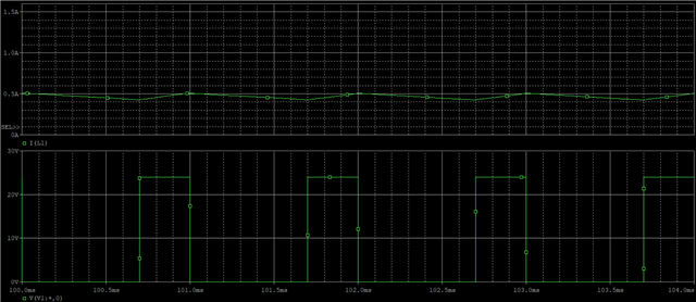

    [Total Graph] - 0~200ms
    /resized-image/__size/640x480/__key/communityserver-discussions-components-files/196/_04C8B4CC0CD315D6_.png

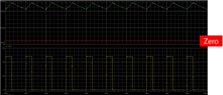

    [PWM Graph] - 100~104ms
    /resized-image/__size/640x480/__key/communityserver-discussions-components-files/196/2068.PWM.png
    Cycle : 1ms , Duty : 0.3ms,  Current : 0.4~0.5A
    We want to obtain this data.
    But, Test data is a follows.

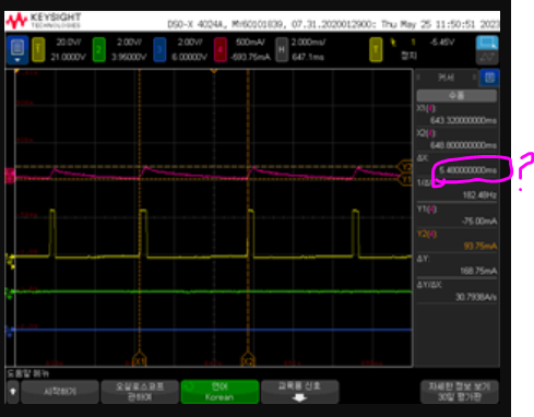

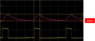

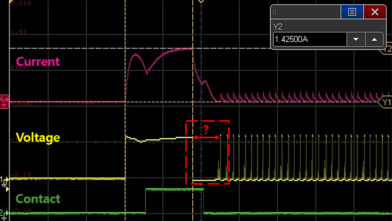

    [Total waveform]
    /resized-image/__size/640x240/__key/communityserver-discussions-components-files/196/6862.scope_5F00_67.png

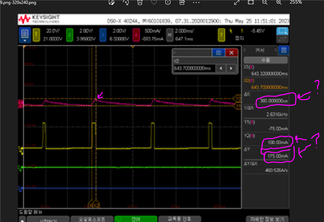

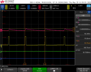

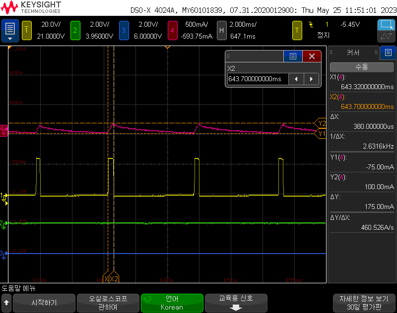

    [PWM waveform-1]
    /resized-image/__size/320x240/__key/communityserver-discussions-components-files/196/5857.scope_5F00_68.png
    [PWM waveform-2]
    /resized-image/__size/320x240/__key/communityserver-discussions-components-files/196/4300.scope_5F00_69.png
    Delay Time :89ms, Cycle :5.48ms(182.48hz), Duty : 0.38ms, Current : 0~0.17A
    Based on the waveform, it appears that the current should reach zero for the cycle to progress.
    Other waveform is same.
    please check it

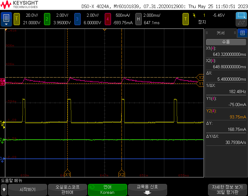

  • Hi Gilho,
    I believe I understand your question now. I will need your help in identifying the following values as the scopeshots are quite blurry. Or perhaps you could send higher resolution images.
    My theory is there is a difference in your simulated load and your test board load. It appears your test board completely dissipates the energy, bringing the inductor current to zero before the device is re-enabled while the simulation enables the device while the load is still dissipating the energy.
    Please see what differences exist between your simulated load and your schematic.
    Elizabeth
  • Hi, Elizabeth
    Thank you for your appreciation.
    I have uploaded the requested test waveform again.
    I see that there is a difference between the waveform shown and the simulation waveform, despite using the same load. However, the test was conducted using the DRV-103, while the simulation utilized a simple RL load with PWM source.

    Thank you for sending those scope shots. It is clear based on those scope shots the device is not setting the frequency we are intending based on the external resistor (f=1203 Hz / 0.8ms period) and instead we are seeing a 5.8ms period/ 172Hz frequency. Can you confirm this is occurring across multiple devices?
