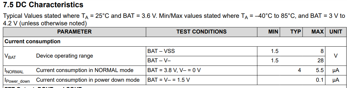

    We looked over the schematic and there are no further recommendations. As for the quiescent current, it will be limited to the datasheet spec in normal operation as shown below:
    Hope this helps!

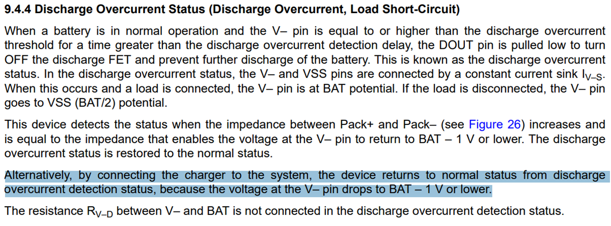

    but i want to ask if any fault happened like short or under charge or over charge...etc am i required to reconnect the charger again?
  • While reconnecting the charger restores the device to normal mode in some cases, each fault condition will have a specific recovery condition which are specified in section 9.4 Device Functional Modes of the device datasheet.
    See overcurrent in discharge fault as an example:
