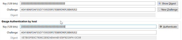

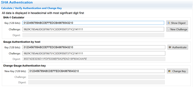

  • Hi Wyatt,
    The Legacy_sha1 bit is set to 1.
    Below is the screenshot of authentication through sha1 authentication in BQ studio.
    I am trying implement the same through advanced SMB command. Below are the steps I followed.( Did not modify the key, using the default 128 bit key.)
    1. Write 2f followed by 20-byte random challenge "2F 04 16 53 11 9B 43 EB 93 56 50 61 81 C2 BD CB 35 9D 7A C1 A3 "
    2. Read from 2f to get the authentication response, the response through SBS is incorrect.
    The expected response is
    Could you please let me know if i am missing any steps in between. I have attached the .gg file below.

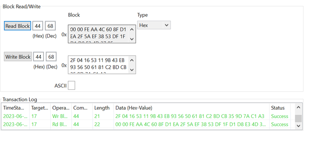

  • Hi Wyatt,
    This is the random number challenge generated from BQ studio, "AE41806FDAF55D71593D0FE7EB89D90F28B692E2"
    I am sending it in little endian format through MAC Block access..
    New Challenge( Tried with 0x2f Authenticate()
    2F E2 92 B6 28 0F D9 89 EB E7 0F 3D 59 71 5D F5 DA 6F 80 41 AE
    Below is the response I get. Could you please let me know the advanced sbs command format to send a new authentication challenge from BQ studio.
    Reshmi
  • Hello Reshmi,
    A couple of things to clarify:
    • Make sure the auto-refresh is off during any testing with the advanced communication tab.
    • Your command structure looks incorrect, the command 0x2f and response 0x28 should be in the input section closest to the button, where you currently have 0x44. 0x44 will not give the correct responses.
    Sincerely,
    Wyatt Keller
  • Hi Wyatt,
    Thank you!
    It is working now. Explanation for 2F/28 in TRM says block read and write, so I thought it was MAC block access command.
