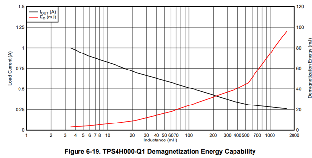

TPS4H000-Q1: I-V curve of Vds clamp
Part Number: TPS4H000-Q1
Hi expert,
what's the minimum and maximum current that allowed to flow through Vds when VDS is clamped ? as far as i know, ther are two values, one is IT and another is Ipp like below picture shows.  can you share this information cause i did not find in your datasheet, thank you.
