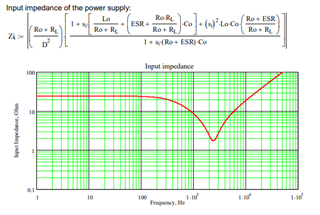

I want to calculate the input impedance of the Power IC LM5143A and need to compare it with the the Pi filter output impedance. Can you please help me on this how to calculate this value.
I got an appnote from TI for the reference https://www.ti.com/lit/an/snva538/snva538.pdf But this is not enough for the calculation as in the example section there is some mismatches in the value so I am confused on how to take this values properly in my case.
