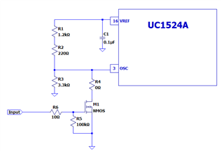

Please show me a picture of the circuit diagram of the electrical parts that connect to the OSC terminal.
You can use a typical timer 555 circuit for your intended frequency then connect that circuit to OSC.
I would like to connect the circuit (1) or (2) to the OSC pin.
Do you have any concerns?
(1) I am trying to connect the Y pin of the TC74HC00AP to the OSC pin, but are there any concerns?
(2) Is a damping resistor required for the OSC pin?
If so, how many ohms would be a guideline?

(1) if peak voltage at about 3.5V then ok.
(2) No need in general, if the sync signal connection is very far away, I suggest to use twisted pair wire Y and GND.
(3) OSC to GND has a resistance 2kΩ. For a 3.5V peak, the current OSC requires is 3.5V/2k = 1.75mA.

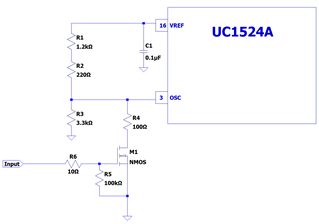

I applied the following voltage for external synchronization to the OSC pin and ran it for several minutes. Then, I think that UC1524A is broken. (It took a few seconds to start up, and the OSC stopped accepting external sync signals.)
■ High: Apply DC +5V
■ Low: Shorted to GND
Please let me know if there are any factors that break the UC1524A in the above usage.
please provide the synch signal waveform. I mentioned 3.5V but you mentioned 5V why you did not follow my mentioned voltage value?
Yes, based what I know and that is why I mentioned several times to keep it at about 3.5V
I suggest change R3 with a 3.3V zener with 2% zener voltage tolerance.
You can also use 3.6V zener but make sure it’s tolerance with max 3.7V
OSC has an internal resistance not a specified parameter so a fixed R3 may not work.
