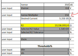

We are looking into the supply voltage supervisor: TPS37044,. We would like to calculate the accuracy of the device for 4 different rails 1V, 1.2V, 1.8V and 3.3V that come from the PMIC.
To do this calculation we are using the excel sheet from the following webpage: TPS3704-ADJ-CALC Calculation tool | TI.com
  • In the excel sheet you need to full in the Isense multiplier. What is a good value for this?
/resized-image/__size/320x240/__key/communityserver-discussions-components-files/196/pastedimage1685972751013v1.png
/resized-image/__size/320x240/__key/communityserver-discussions-components-files/196/pastedimage1685972981772v3.png
  • Further, is the answer from this excel sheet the values on which I can base my accuracy assessment?

  • Hi Wouter,
    The calculator is OK to use for the accuracy calculation. An Isense multiplier of 150 should be within the OK range. A minimum multiplier of 50 is recommended. The lower the multiplier is, the more accurate the device will be at the cost of power efficiency. This application note explains in detail: https://www.ti.com/lit/an/slva450b/slva450b.pd
