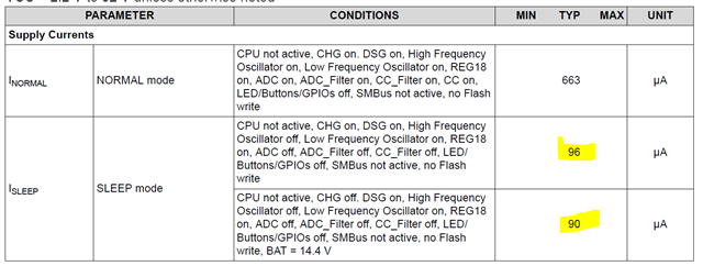

The BQ40Z80 current consumption during SLEEP mode is 96uA based on the data sheet.
The BQ40Z80 in SLEEP mode will wake up periodically for voltage, temperature, and current measurements to reduce power consumption.
Is the periodic voltage, temperature, and current measurements included in the 96uA current consumption?
Or the current consumption in SLEEP mode will be higher than 96uA when there is voltage/temperature/current measurement? Is the current equal to 663uA when there is voltage/temperature/current measurement?
If yes, the average current during SLEEP mode = [(Isleep x Tsleep) + (Inormal x Tnormal)] / (Tsleep + Tnormal), correct?
