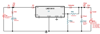

Why is the load step response unstable for the WEBENCH's default sample circuit shown below? is this real? or a bug in the tool?
Vin=28V
Cin=39uF, ESR=25mOhm
Rfbt=5.62kohm, Rfbb=1.07kohm
Cout=3x 270uF, ESR = 8mohm
load steps = 0.5A - 5A
Vin=28V

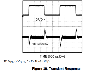

This looks to be an error in load transient simulation given that the load transient occurs after a delay and load transient voltage simulation doesn't look correct. This is a bug in the tool.
If you looked at the datasheet transient response for 12Vin|5Vout|1Ato10A using the LMZ13610EVM you would expect more of the below. The overshoot and undershoot should happen during the load transient rising and falling edge of the load.
