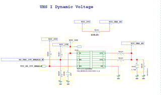

TLV710: TLV7103318QDSERQ1
Part Number: TLV710
We are using TLV7103318QDSERQ1 in our design for dynamic voltage scaling of SD card. This design is referred from the one used in Jacinto 7 EVM design. I have attached the schematic from our design. Please review and confirm the design!
Also, Please confirm the features mentioned in this document is applicable to TVL7103318?
