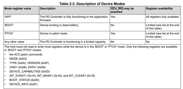

    Also, are you able to tell under what circumstances the mode register gives "BOOT" or "PTCH" value?

    If i set to EVM to "Always Enable Sink", i noticed what even there is no eeprom, the mode register is giving me "APP". The TRM mentioned "USB PD is disabled until configuration is loaded." in this mode:
    1. Is the configuration here refer to the low region binary?
    2. If using "Always Enable Sink", what is the command to go into "PTCH" mode? I tried to GO2P & GAID, both command giving me !CMD.

    Since you are loading your configuration from MCU, you would want to be in AlwaysEnableSink mode which is the preferred method of loading a configuration from MCU. This will allow the sink path to be enabled so that system can provide power to MCU for flashing.
    AlwaysEnableSink should not boot into APP mode unless there is a valid configuration loaded. If you have an EEPROM attached, it will load configuration from the EEPROM and boot into APP mode. Make sure there is no EEPROM attached.
