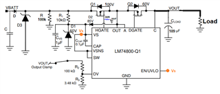

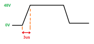

In the jumpstart test, the voltage goes from 0V to 48V in 3us and stays there for 1 minute. As a result of the test, the mosfet (Q1) remains as a short circuit, and after a while the OVP is broken.
I created a similar schematic of the product I designed, below.
What should we do both to pass this test and to pass the 7637-2 pulse tests that we will enter in the future, thank you in advance for your support.
  • Q1 transistor part number: BUK6D385-100EX
  • Hi Omer,
    The schematic looks good to me. I do not see any reason why a 100V FET would be damaged when 48V is applied at its input.

    My first prediction is that the inrush current is burning the mosfet. When I reduced the output capacity by 100uF, I saw that the mosfet did not deteriorate.
    but I need to use that 100uF at the output and I would be glad if you could help me solve it this way without changing the layout.
  • Hi Omer,
    If this is a MOSFET SOA issue during startup, you will have to increase the Cdvdt capacitance from 10nF to higher value. This will increase the turn ON time of the FET. I can provide you the Cdvdt value to maintain the FET operation within its SOA if you can provide the below details,

  • Hi Omer,
    The BUK6D385-100EX FET does not have decent SOA and is not suitable for operating in saturation region.
    I have tried calculating the Cdvdt required to get good SOA margin during startup at 48V with 100uF capacitor  but could not get any SOA margin even for higher Cdvdt capacitors.
    The only solution here is to replace the BUK6D385-100EX FET with another FET which has  better SOA.
  • I increased the 10nf to 100nF in the snubber circuit connected to the HGATE (at 25°C ambient temperature). the mosfet is not broken. If the product continues to work in this way, will we have problems in the future?
    My new concern now is will we have trouble with the 7637-2 pulse 3b test? (TVs diode at the input clamps at 77Volta)

    Our calculations for FET SOA include calculations at Max Ambient temperature and  FET SOA derating for temperature. So, you may see the FET may not fail at 25C operation but it can fail at higher temperatures.
    ISO 7637-2 Pulse 3B is a very fast repetitive pulse of 100's of ns that is usually absorbed by the input and output ceramic capacitors. What is the TVS used at the input ?

    TVS PN: TPSMD48A
