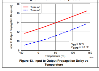

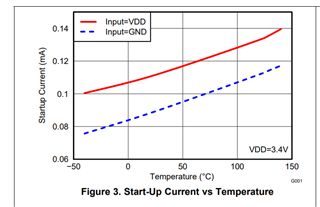

  • Hello Sherry,
    There is no direct way to measure the Tj of the device, so I have seen people come up with ways to determine the Tj based on the change of certain device characteristics.
    For example, you could determine Tj of a device using this chart:
    By measuring the startup current (hard to do while the device is running). Or you could look at prop delay:
    So if the turn on delay is 15ns, you know Tj is around 100 C. I have seen this done in a few different ways, so these are just examples. This is one way to calculate Tj, rather than using thermal modeling. It has drawbacks also, so this is just one possibility, especially if the customer thinks the Tj calculation is off.
    Alex M.
