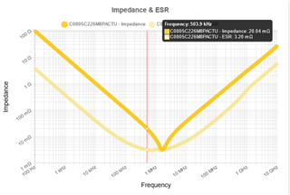

    3. Is the ESR calculated for C_OUT_ESR a maximum ESR? What frequency is this supposed to be calculated for, the switching frequency of 500 kHz? The image below shows Kemets Ksim tool for a capacitor at 500 kHz (click it so that it's not blurry).

  • Hi Michael
    Yes, Doule the C_OUT_min capacitor for a safety factor is this OK;
    It's maximum ESR. Yes the 500kHz switching frequency should be used(use 1.1MHz when you choose LMR51420Y);
